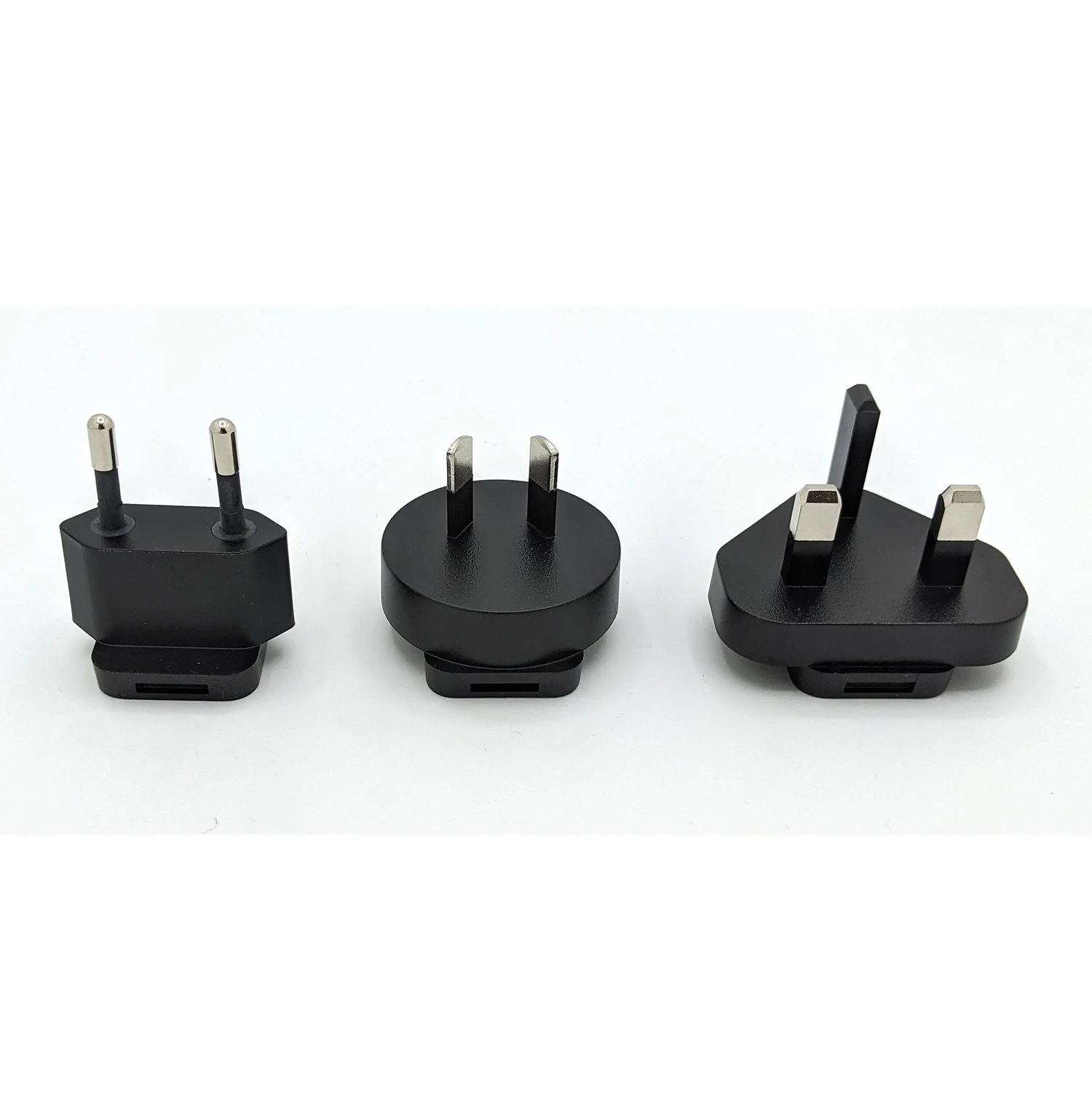

Power Adapter: Now available with choice of UK, EU, and AU adapters.
