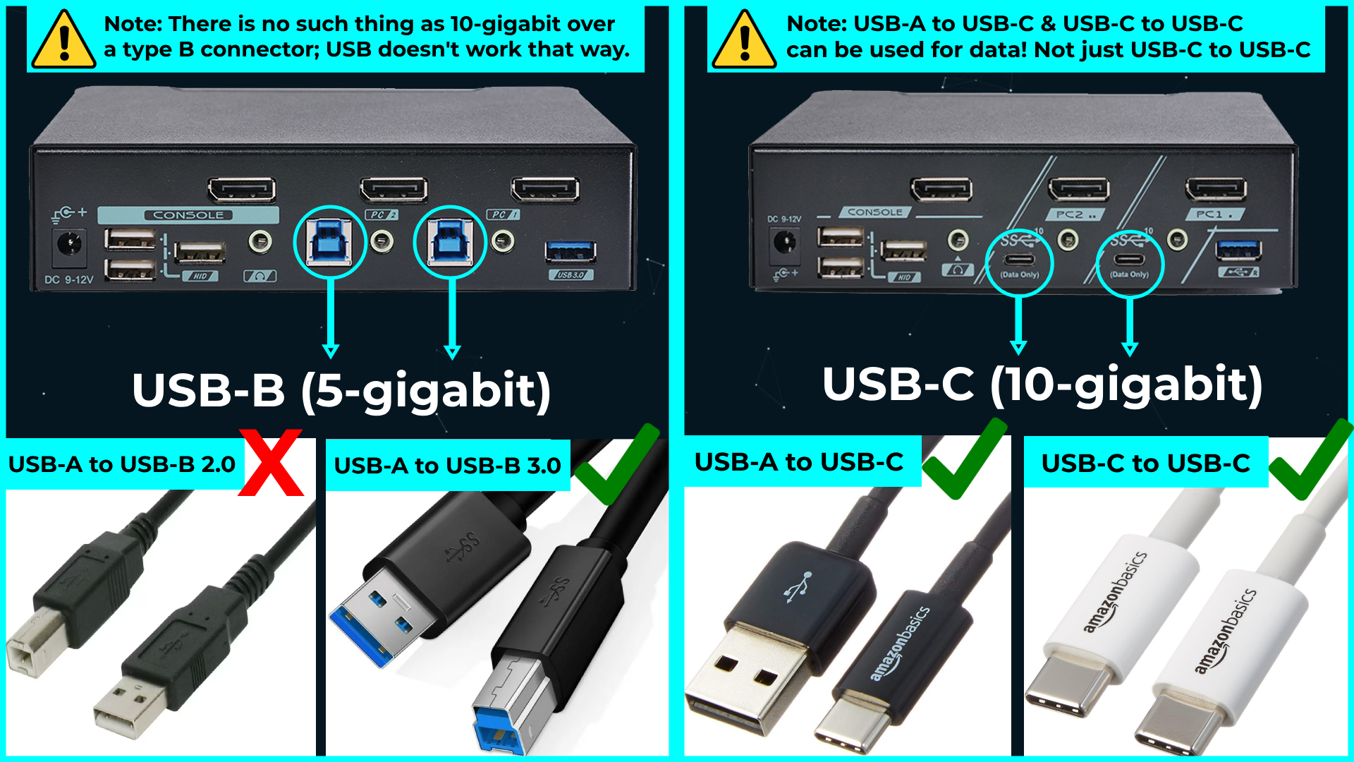

Rear Inputs:
  • 2x 3.5mm Audio (may need a ground loop isolator)
  • 2x DisplayPort 1.4
  • 2x USB 3.0 "B" type (USB 3 5gbps, or USB 3.2 gen 1) [5gbps model]
  • 2x USB C (USB 3 10gbps, or USB 3.2 gen 2) Data Only Inputs [10gbps model]

Important Usage Information: No cables are included. Purchase here: Display Port 1.4 200cm Cable
Please only use DP cables that carry the ground but not voltage (19 pin) & are no longer than four (4) meters.
