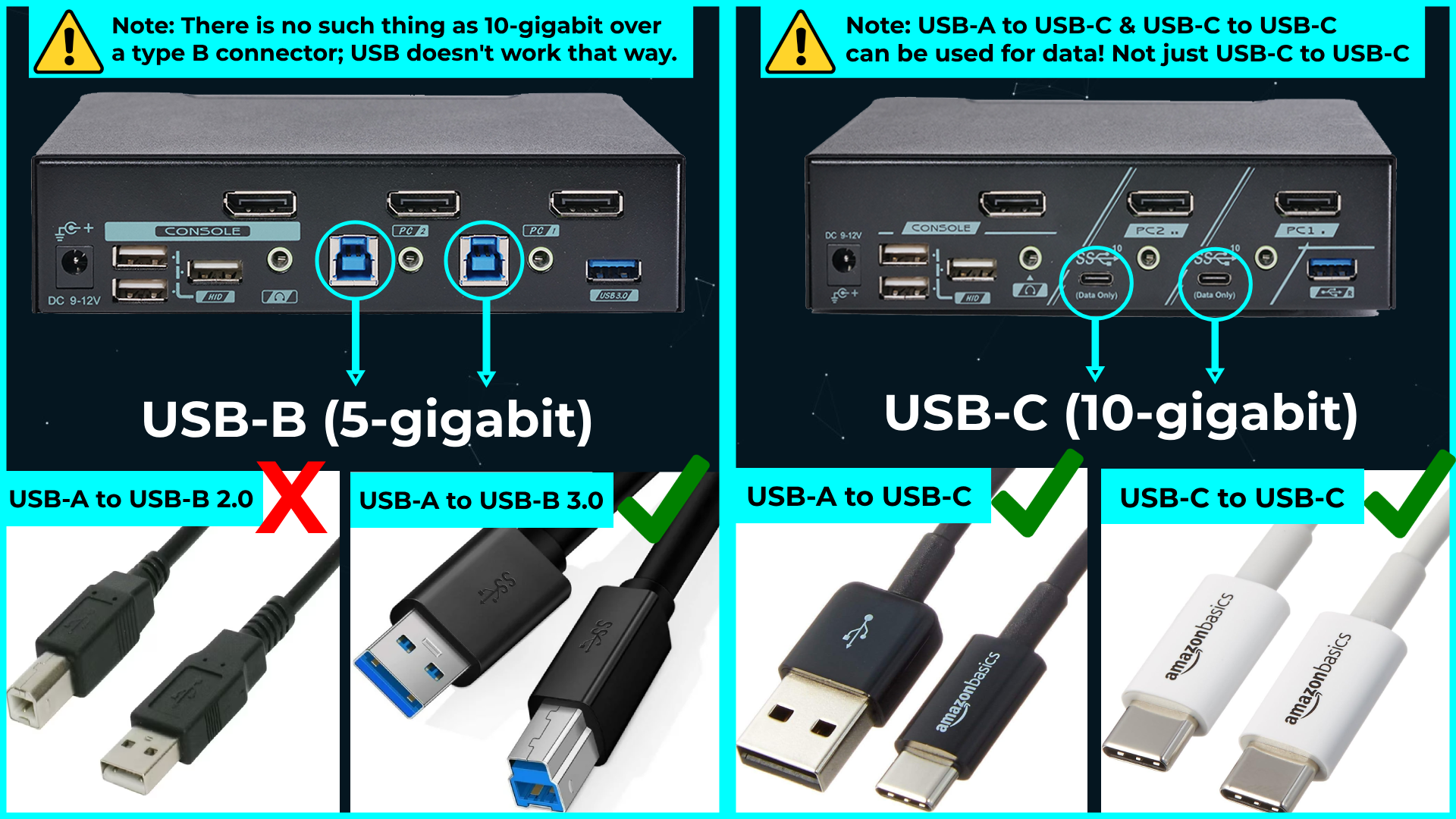

  • works with USB 3.0 (USB 3 5gbps, or USB 3.2 gen 1) peripherals as well as USB 2.0 HID devices.

Rear:
Inputs:
  • 1x 3.5mm per PC (may need a ground loop isolator)
  • 8x DisplayPort 1.4
  • 4x USB-B 3.0
Outputs:
  • 2x DisplayPort 1.4 connection
  • 3x USB-HID
  • 1x USB 3.0 (USB 3 5gbps, or USB 3.2 gen 1)
  • 1x analog 3.5mm audio
Front:
  • Push buttons for switching to each of the 4 Inputs
  • 1x USB 2.0 HID port
  • 1x USB 3.0 (USB 3 5gbps, or USB 3.2 gen 1) ports (up to 1A current)

Important Usage Information: No cables are included. Purchase here: Display Port 1.4 200cm Cable
Please only use DP cables that carry the ground but not voltage (19 pin) & are no longer than four (4) meters.
